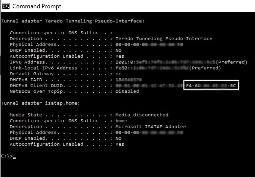

I have sorted how to get your 60 day PRO evaluation of the Microchip XC8 License.
First - download and install the XC8 installer and set it up with FC7 as shown above. Once installed you need to make sure you make a note of your Host ID. If you have already install your compiler, you can find your Host Id as follows:
Run the CMD prompt and type: ipconfig /all
Your host ID is your computers MAC address as shown here: Its the last 6 pairs of number without the colon punctuation.
Then go to this Microchip page: http://www.microchip.com/xcdemo/GetDemoLicense.aspx
To download your Windows batch file to activate the xc8-Demo as shown above. Why now develop your project and then take advantage of the fantastic offer.
