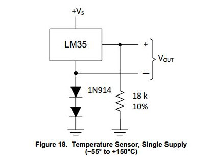

Re: Reading an LM35 sensor in minus degrees 16F690
HI
another way for a single power supply is shown in the attached datasheet (fig 18)
call vout + V1
Call vout - V2
connect each to an adc input and use this calculation temp=(v1-V2)*100 deg c
Hopefully it will work
Well yes Kersing is correct the next question would be how do you measure negative voltages with the PIC ADC ?
would ne bice if some one can explain this
Thanks to all who responded to my request.
Dazz, I saw the figure 18 drawing but was totally confused with 2 outputs to the PIC instead of one, now that you have explained to me that I need to take both into ADC inputs and make the calculation, it makes a lot of sense!!!! I will try it and let you know how it went.
Hi Dazz
Your advice on the LM35C sensors was spot on, only thing that I had to change was to remove the "*100" part of your formula. Following my program below gives you the temp accurately, no need to multiply by 100.
So to read the LM35C sensor for minus temperatures, follow the datasheet fig 18 to the letter, then write the program as follows:
You need 2 ADC inputs as Dazz has correctly mentioned per sensor, one for positive output from sensor the other the "negative" output which is slightly above ground due to the 2 1N914 diodes.
Get INT on both iputs ie tempPos and tempNeg
tempPos=tempPos*49/10
tempPos= tempPos/10
tempNeg=tempNeg*49/10
tempNeg=tempNeg/10
TempResult=(tempPos-tempNeg)
Now you can display TempResult on an LCD display with minus temperature readings.
Thanks to all for your valued input, this is how we all learn together.
Ted
