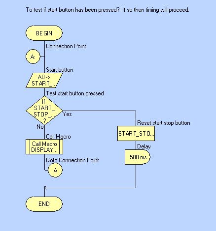

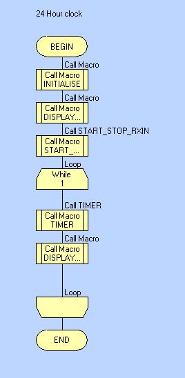

I have adapted tutorial 22 for my stop watch project. I have implement a start button macro with debounce. I am finding it difficult stopping the program as a stop watch. Could anyone suggest how I could implement the stop and reset button please?
Thank you
Thank you
- stop_button.JPG (21.66 KiB) Viewed 18416 times
- stopwatch.JPG (17.17 KiB) Viewed 18419 times

Hello Ziggy
The Stop button has to disable the timer0 interrupts. This will stop the internal variables from counting and can be done by using an interrupt flowchart icon.
The Reset button has to assign 0 to all of the internal count registers. Eg secs, mins, hours etc.

Ben,
I have successfully implemented the stop and reset button respectively, thanks for the hint. I want to use a 4 MHZ crystal to generate a 100ms interrupt. I downloaded a piece of software called "Pic Timer Calculator Version 4". The software recommends a timer offset of 100, a prescaler ratio of 1:64 and calculated that a 99.5222 Hz timer freq will allow 1 instruction cycle time to equate to 10048 micro seconds which is not far off the interrupt time I want. In Flowcode, a prescaler setting of 1:64 for a 4 Mhz crystal allows an interrupt frequency of 61.0352 Hz. How do I implement the equivalent of a timer offset and will I be able to achieve a 10048 micro seconds interrupt?
