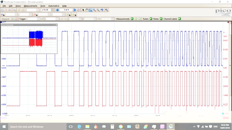

Made some progress. It's not missing count's. There seems to be some extra erroneous signals being counted on the end of the return stroke. There for the count is less than before movement.
This was taken on the output side of the line receiver. Input to Pic.
The movement is off hard stop then back to hard stop. Vibration in the 'tone wheel' is one thought (not convinced though) - it is driven by a 2.5mm shaft 80mm long. I'll have a look on the input, both channels, side of the line receiver next for the blue channel.
Thought I'd post up in case anybody has come across this.
Andrew

But why would the counter decrease?
Wouldn't that be calculated as vibration as the red channel is not switching?
Note: Complete amateur at this, which I'm sure is obvious.

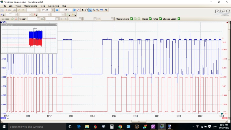

I think I may have the answer.
The data transfer to interrupting the polling on the pins. Is that a possibility?
Is there any way round this?
Blue channel - Encoder
Red - TX on display
Cheers
Andrew
Red - TX on display
Cheers
Andrew

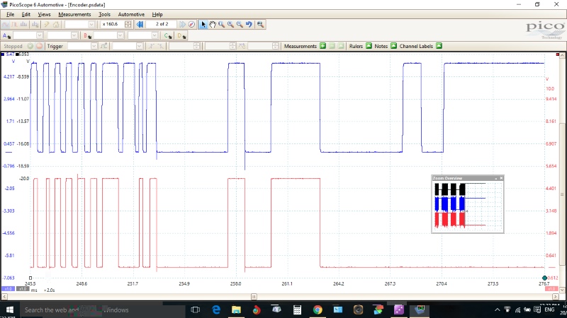

I’m still not given up on this. I have written a short program to look at the chip’s reaction. Now I am even more confused as this ‘seems’ to imitate the results I have been getting.
Basically I have the chip using a IOC on port B. All the chip has to do once the interrupt has occurred is to check the state of the pins then change the state of two pins on port C to a corresponding state.
The results:
At the start Port C output mirrors the input almost perfectly. Blue is the input into the chip. Red is the output. Only looking at one channel.
After a change in direction a delay has occurred between the input and the mirrored output.
At the end, it just gives up and is now badly missing counts.
These results are the same time and time again. And seem to fit my poor counting results.
Any ideas? I can’t figure this logic out.
Thanks in advance for any input.
Andrew
The results:
Andrew

But corrected it and now the behavior is as expected (one missed switch). So now I'm just adding one piece at a time and see what happens.
AndrewC
- Flowcode v5 User
- Posts: 28
- Joined: Wed Oct 02, 2013 12:16 pm
- Has thanked: 7 times
- Been thanked: 7 times
Re: Software or hardware problem?
Oh the sweet, sweet taste of success!!!
A beginners error that caused a huge headache. Not that I understand it, but I can, at will, make this run as sweet as a nut or run like insane mad man. The polling did not work (for me in this case) as it appeared to stop polling/counting while comms was happening, around 30 ms long, which was why the count was incorrect in that case. Even tried changing the Baud rate to 115200 but still lost around 17 ms.
So IOC was the way. The error I had, again a miscount which added to the confusion, was caused by having all four pins on PortB IOC configured to IOC. As soon as I assigned only the pins I was using to the encoder, perfect.
I'm' not sure why the unused pins gave me so much trouble. They were only attached to the fly lead for when I used the Pic programmer - PGC, PGD. But it caused havoc with the interrupts, sometimes missing non, sometimes just missing one (as mentioned above), other times missing many as the image shows. I'm not even convinced it was counting correctly when it didn't seem to miss an interrupt. It was such a simple error that drove me nuts.
Any way, very happy now. The project is to display the angle of a cutting arm, used to facet gemstones on diamond impregnated copper discs. It's now accurate to about 0.07*. Most of the error there is in the linkage to the encoder as a tap and it will settle to with in it's 0.0225* resolution. I'll post an image once I have it finished. I've attached the program with the toggling pins that react to the interrupt. Again only one channel.
Cheers.
Cheers.
