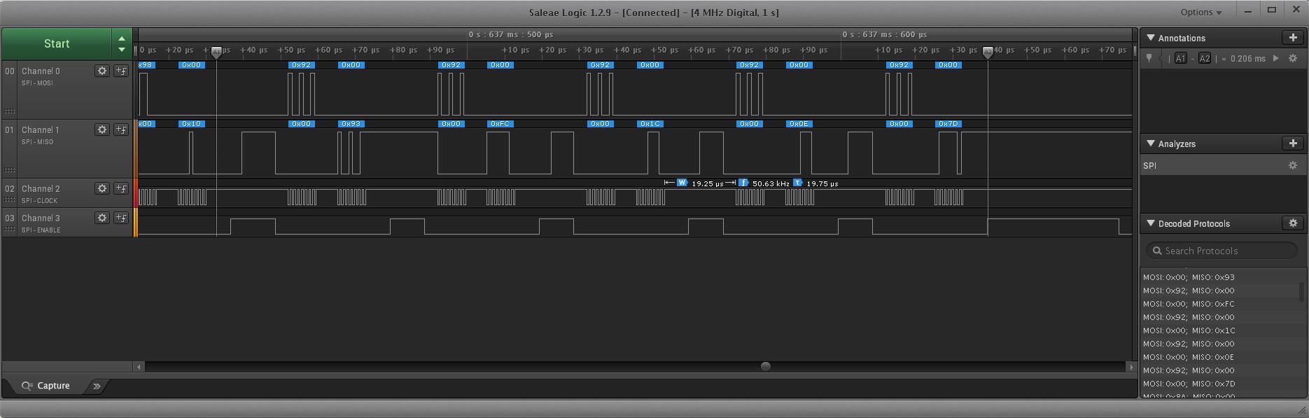

I try to read serial, but rc522 component give me incorrect number. Card number 236780691, hex may be 93 FC 1C 0E 7D, logic analyzer gives me same number, but component show 1C FC 1C 0E 7D. First number repears third. And this is on all cards.
(118.2 KiB) Downloaded 4661 times

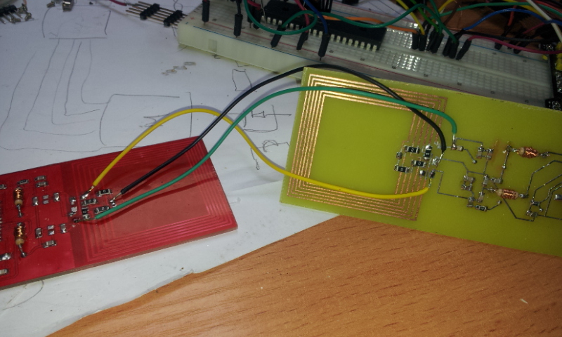

I am installing the RFID in a box, but the card can not be read, you can put an antenna outside (PCB or wire) of the box and connect it to the RFID, to that the signal is stronger and can be read.
Someone tried to do this :?:
Thank you

Hi, electron67
I make an experiment with external PCB antenna - adding about 13cm simple wires - it works beautifu!
