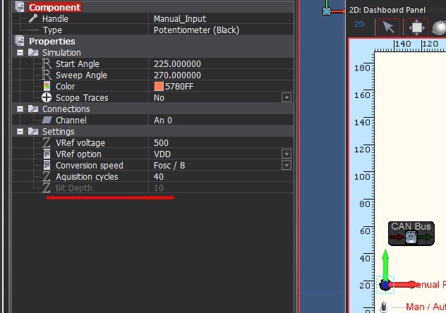

I am obviously not sure what your program is doing but, I would suggest you check that the assigned macro/variable you are using to read the 'POT' is 10-Bit wide (this is what is showing up in the properties window). This would produce a value greater than 0-255.
ADC_Pot 10-Bit Width
Just a thought.
