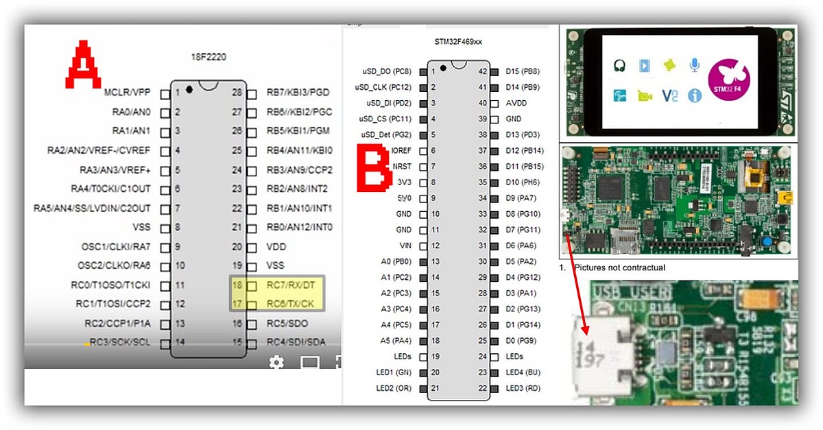

In this tutorial https://www.youtube.com/watch?v=O_cPIL2LudY it is explained
that if you use the yellow marked pin 17 1nd 18 (Image A), then Flowcode use the hardware UART with
internal buffers - but you can use any pin and Flowcode creates a software UART
In Image B you have STM32F469-Discovery
How can the "User USB" be used as UART
(for serial communication with PC)
where UART works with high performance with the chip hardware and the internal buffers ?

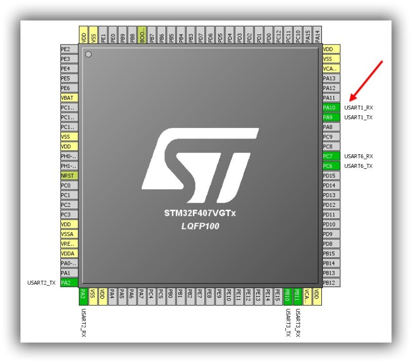

The same question applies for STM32F407VGT6. (The biggest chip supported by flowcode i think.)
UART 1 occupies PA9 & PA10
IF a UART is created in Flowcode and given PA9 & PA10
will it then automatically use the hardware resources on chip for UART1 ?

Yes, if you set the properties of the Flowcode UART to "Channel 1 - USART1" and set the connections to PA9 & PA10The same question applies for STM32F407VGT6. (The biggest chip supported by flowcode i think.)

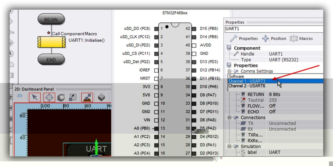

Re: STM32 ARM UART
LeighM wrote:
> No, we don't yet support the USB peripheral (e.g. a virtual COM port)
But flowcode UART component indicates that there are two hardware USART available and one software version.
See image.
As reply to Stefan Erni: If the USART hardware is available there should be no need to buy any further board.
Looking forward to Matrix comment on this....

Re: STM32 ARM UART
OK, sorry I'm getting a bit confused as to what you are trying to do.
Yes there are UARTs supported, so you could connect the UART to a FTDI type board then via the USB to a PC, as a virtual COM port.
I thought you were wanting to go directly from the USB on the Discovery board (which is not yet supported)
As for the STM32F407VG, it would be best if you could start this yourself, based on my example and the previous notes, and see how you get on.
Then let us know when you need further help.

The USB UART, provided on most ST boards via the ST-Link chip, can be selected from Flowcode.
It seems that all Nucleo boards (32-pin, 64-pin and 144-pin versions) have connections to the USB UART by default.
Not all Discovery boards provide this feature, but the F429, F469 and F746 LCD boards do.
The required UART pins do not appear as I/O if they are not available externally, but can be selected as connections in the hardware U(S)ART component properties.
USB U(S)ART Examples:
Discovery F429 - USART1: TX = PA9; RX = PA10 (Note: SB11 and SB15 must have links added)
Discovery F469 - USART3: TX = PB10; RX = PB11
Discovery F746 - USART1: TX = PA9; RX = PB7
Nucleo 32-Pin - USART2: TX = PA2; RX = PA15
Nucleo 64-Pin - USART2: TX = PA2; RX = PA3 (Note: D0 and D1 on the Arduino connectors of these boards are open-circuit with the default jumper settings)
Nucleo 144-Pin - USART3: TX = RD8; RX = RD9

ok, I can connect now to the pc and receive the string. I can use 921600 baud. it's working on win7 and win10.
The last Problem was on the propertis/Connection from the uart3, I can not see remaping TX and RX.
But when I clicked in the "triangle" and I choosed B10 and B11 it was working.
