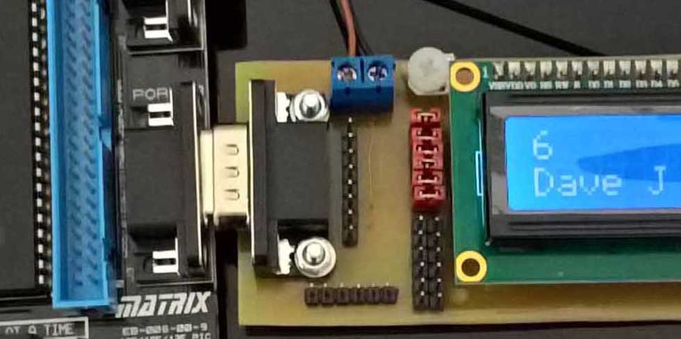

I am trying to venture into the realm of USB. I am using the following hardware:
- PIC18f4550
- EB006-30-9 Multi Programmer
- EB055-30-1 USB board (my design copied from Matrix)
- EB005-30-4 LCD Display (my design copied from Matrix)
The Flowcode program I am using is shown here:

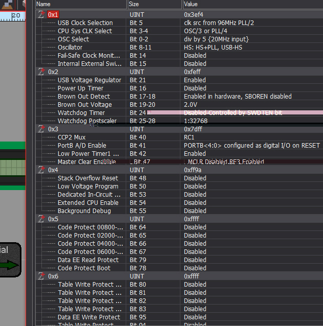

The PIC18f4550 setting are shown here: The program appears to run ok on the hardware with LCD displaying correctly when connected to the computer (Windows 10 Pro Build 1607)

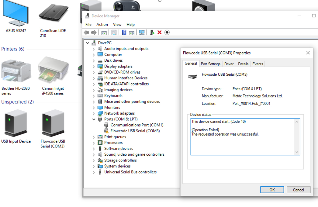

This is what my PC show when trying to communicate to the hardware connected. I am using the driver obtained from the project folder (Flowcode_USB_Serial_Driver) generated when compiled - I am in no rush to get this working, but would need to include the USB feature in future designs.
Any advice would be very much appreciated as what I may be doing wrong or missed.

Thank You for quick replay. I have treid to update the driver to the one you have suggested, regretably, same problem.
Here is what Windows 10 displays:
I just don't know what the problem could be as to what is stopping it from starting! I am not that bothered about it being signed, I just would like to run.
Dave

Looks like it could be a configuration problem. What crystal are you using on the EB006 board? I'm assuming you've replaced the 19.6608MHz crystal with a 20MHz crystal. I'm told the 19.6608MHz crystal does work but it's probably right on the edge of working and would recommend using the right value of crystal if available.
The Build -> Project Options should have a clock speed of 48000000 as your multiplying the 20MHz up to USB speeds using the PLL. This will only effect things like delays and other timing critical parts e.g. UART baud rates.
In the Configuration tab set the CPU SYS CLK Select to OSC/1, this is hopefully what's currently stopping it from working as you currently have it set to OSC/4.
The other config settings look ok.

I have dug a little deeper and found this:
So, not sure how to fix this one, I think its a 'Windows Device Policies' issue. I'll work on it over the next couple of days to see what I can find regarding 'PnP' USB communication. I'll keep you posted.
Dave

Yes, I have installed and uninstalled the driver. The problem was not the driver itself but the signature catalogue that ships with the driver. Windows just would not accept it. I have now resolved this issues. Everything is working correctly.
The problem caused by the signature catalogue not installing was - I could get the driver to load and the PIC would work. However, after unpluging the PIC and pluging it back in, it would not work, driver failed to run again.
Microsoft UEFI states - the driver was installed as 'developer mode'. So, how to make it permanent was my difficulty. Sorted now though. I'll by posting how I achieved this.
Another option suggested was to turn off secure boot and then install the driver. Once it is installed and working you will be able to turn secure boot back on and keep the driver in the protected driver environment - working.
Hope this clarifies what my difficulty has been.
Dave

From the MSDN linkjohnsondav wrote:Hi Grant
Not sure how you accomplish the use of a standard Windows USB driver for your PIC USB communication. I am sure others would like to know how you achieved that.
I have tried many times to get the driver working, but a Kernel driver that utilises PnP is forced to comply with UEFI policies, as of new build Windows 10 1607.
Dave
"If you want to load Usbser.sys automatically, set the class code to 02 and subclass code to 02 in the Device Descriptor. For more information, see USB communications device class (or USB CDC) Specification found on the USB DWG website. With this approach, you are not required to distribute INF files for your device because the system uses Usbser.inf."
Although I was not aware of this and did not alter the FC device descriptor. The FC Cal (usb_config_serial.c) specifies Class = 2 and Subclass = 0
I do understand the issue with the FC custom driver.
