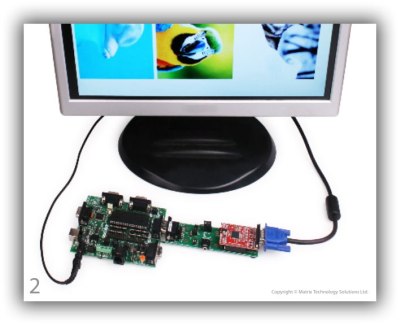

EB071 was a very nice E-block, unfortunately not more in production.
But Matrix has already developed the C-code for it.
It seems that a UART hardware port is used
Is it possible to use it under Flowcode 7 & ARM ?
There is also an upgrade to EB071 - it would be very nice if it could be easily used.
This is the only direct path to a large screen from a processor,
https://www.4dsystems.com.au/product/uVGA_III/
EB071 E-blocks VGA multimedia board under ARM ?

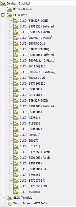

I can't find any UVGA III component.
Is it any of the 4D -
EB076
EB076v2
EB075 ??
How related and compatible are the different 4D components ?
Is there an example file using UVGA III with ARM ?
Instruction how to connect SK-VGA-III without using the obsolete EBLOCK EB071 ?

Re: EB071 E-blocks VGA multimedia board under ARM ?
Sorry my bad, it's in my nonrelease folder so maybe there is a problem with it to warrant it not going in the build.
Here it is but there is no guarantee it will currently work. Simply drop it into your "Flowcode 7/components" folder and restart Flowcode.
Power - 5V
Ground - Ground
TX - RX
RX - TX
Reset - Any Free I/O pin
There are several 4D display families, within each family the API is the same.How related and compatible are the different 4D components ?
Probably not, I would probably start with a 1 second flasher to make sure you can get your hardware running and at the right speed. Once you have this working the display should simply work using a hardware UART channel.Is there an example file using UVGA III with ARM ?
Should be pretty simple, I think the 4D connection includes the following pins.Instruction how to connect SK-VGA-III without using the obsolete EBLOCK EB071 ?
