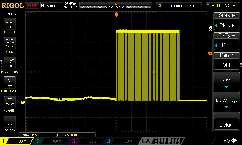

First problem: When i power up the controller, after the PWM enable, it's turns on as full duty until it's get another command.

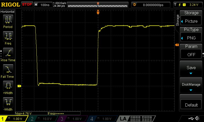

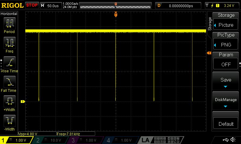

Second problem: Set the duty to 255, simulation shows az 100 %, but in the real HW, it's not 100 %.

It's doesn't matter, where is the SetDutyCycle command. After the PWM enabled, the output goes to full duty until it's got another SetDutyCycle command. I've tested it on Flowcode 5, on that version, only the second problem exists, set duty to 255 is not 100 % duty on the HW.
