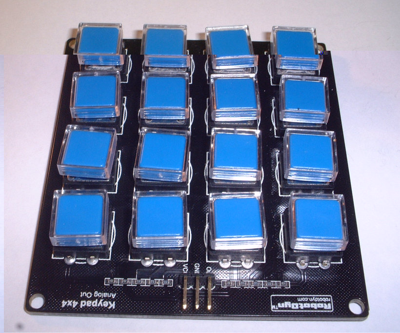

i have used the lcd sheild just reading a single analogue value and then lots of decisions but i agree a component would be good as you can get nice keyboards that only use a single pin of you microcontroller and have up to 16 buttons
