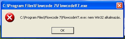

Where is the System requirements? Flowcode 7 free version installed without any warnings, but if I want to start, i got this:
... FlowcodeV7.exe is not a Win32 application. :)
The Win system is very minimal in a virtual machine, separated from the world.

Are you running XP? I think Flowcode v7 needs Vista or higher to run.

Steve wrote:Are you running XP? I think Flowcode v7 needs Vista or higher to run.
steve are you the chief of R&D or not?
why you think needs Vista or higher?
is released on 13. July 2016 - updated wiki - and there stand Windows XP

Yes, i'm using XP only for two reasons: Flowcode and Proteus. The main system is Mac OS.
Ok, no problem to create a new virtual machine. The problem is simple: i can install, but not run.
Message from the installer is missing: "Flowcode 7 requires Windows 7 or newer" -> "Quit Installer" (no other options).
