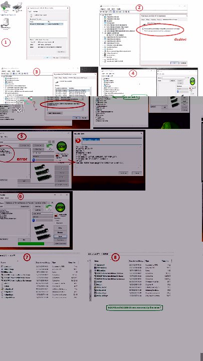

Hi to all !
I´m trying to use the ECIO40P and ECIO28P modules with FC7.2.1, more especifically by the MLoader 3.4.1.0.
I tried with Windows 10 Pro and Windows 8 (both 64 bits) with the exact same final results.
First, I installed the more recent avaluable drivers............................................................................................. (see 7 and 8
It seems ok............................................................................................................................................. (see 1 and 2)
althought I didn´t disable the driver signing, and got
a “The USB/VID…. requires an additional instalation ” message.............................................................................. (see 3).
Then I connected an ECIO40P module to USB port, launched Mloader, and it was apparently recognized.............................(see 4).
Second, I tried to load a previous done MC7 test-file to ECIO40, but after “Send” button, I got a frustrating
“Data Validation Failure” error message......................................................................................................... (see 5).
Oddly, I had access to erase it...................................................................................................................... (see 6).
I tried older drivers versions, but they not even begins the installation.
Please, any clue to fix this situation.
Again, Thanks to all.

I thought I would first try the drivers from the Matrix Web shop
Installed without any issue on my 64 Bit windows 10 Home Version 10.0.15063 Build 15063.
Created a simple flasher to test my ECIO40. Programmed and ran with no issues.
So it looks like the signed version that's on the main website is the same version as on the forums.

Hi. You´re spherically right.
End of Trouble with the clue of these drivers.
Really it worked fluently on Windows 10 !! I really appreciate that !
Good luck on your way.
