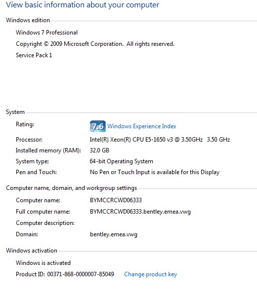

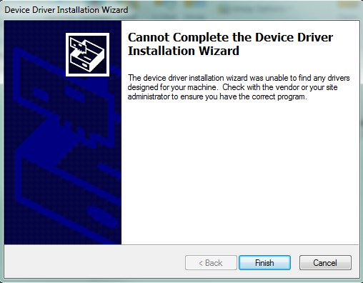

I was not able to install the driver for my EB006 v8 on my computer with Windows 7 professional installed. The installation wizard reported that it could not find any drivers designed for my machine. I have attached some screen shots for info. If you could offer some assistance I would be grateful.
Mark.

Please can you try this driver and let us know how you get on.
download/file.php?id=17762

Thanks for replying so quickly but, this driver had exactly the same outcome.
Mark.

This seems odd. Did you unzip the whole folder and run the "EB006 Driver Installation 64-bit" executable?
