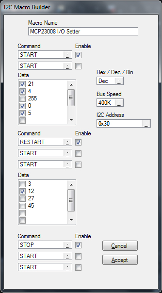

My first thought (before taking a look at the link you gave) was to have a maco builder type thing where you can select what commands and data to send to the device (or get from the device). Once the details are set in a window a macro is built using that info.
I have cobbled a picture of the kind of thing I had in mind, I know it's not exact or complete but it's just what I had started to wish I had when I wasn't getting anywhere. I'm sure from this you can understand my thinking.

I have realised I didn't explain some of the picture...
In the picture those command entries with an enable tick box next to them are drop down selection boxes that have the various commands like Start, Restart, Stop etc in each so that the user doesn't have to work out what they can use it's in front of them.
The data box entries can be as many as needed and are added then enabled by the tick boxes so that only those with a tick will be used, makes for an easy way of trying options out and / or building several macros that are similar or have the same base..
Any of the values could be a value, hard coded (if there is only a small range allowed) or a variable.
Some options, amount of data entries, data values or the commands and command order could be more specific for a device if there was a device selection box too.
Anyway as I said this is where my thoughts was drifting to when I was stuck and frustrated....
