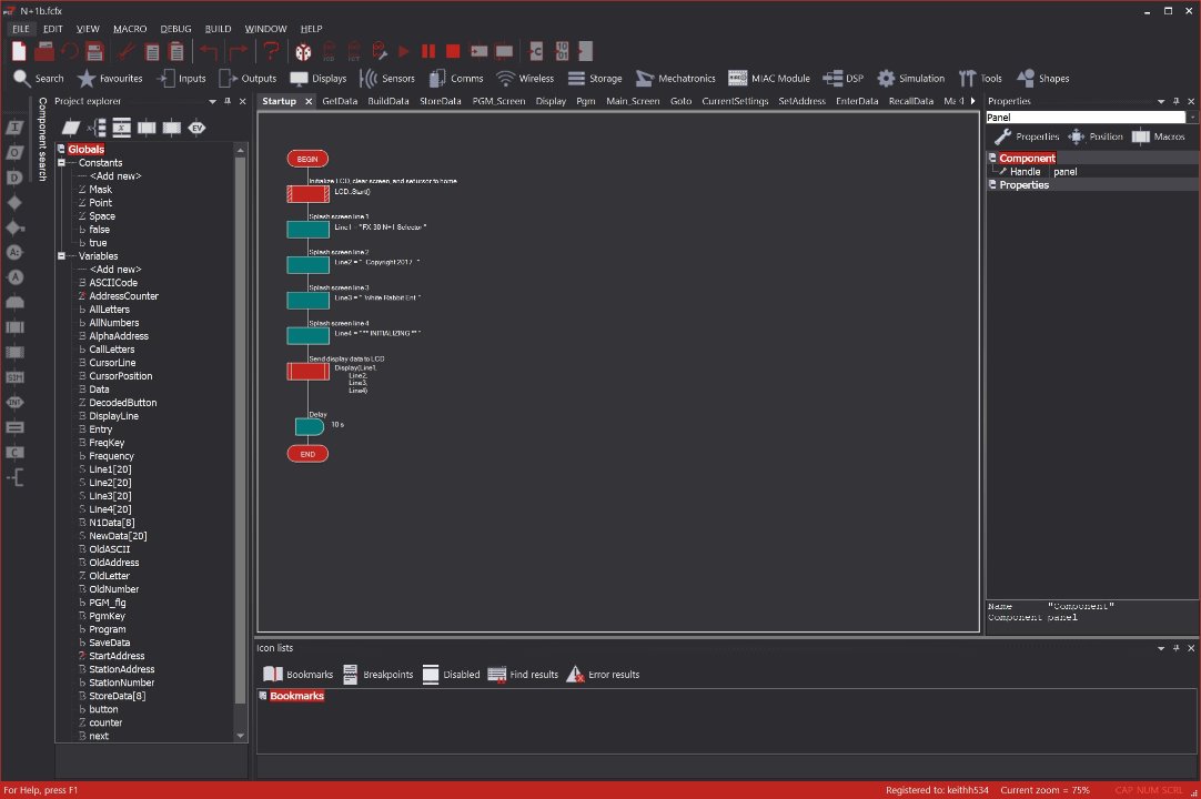

Yes, in the 'Startup' macro as shown below.

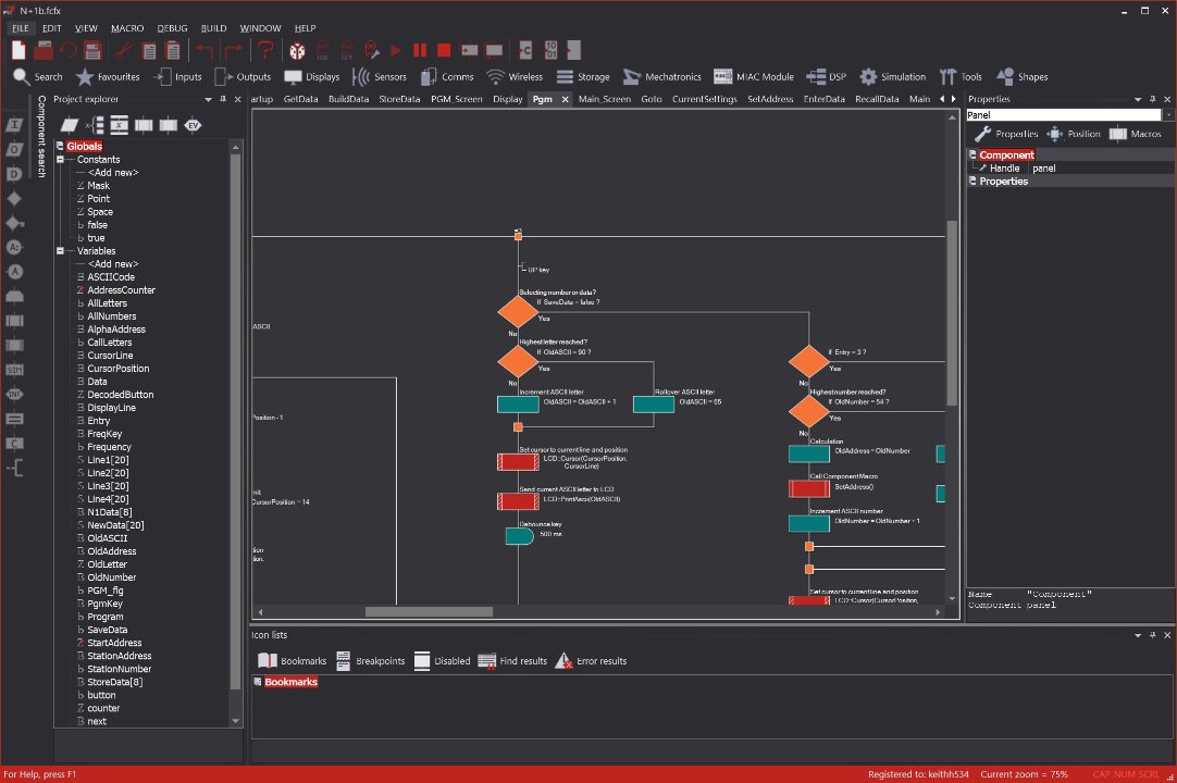

The 'Main' calls 'Startup' which calls 'Pgm' when the 'PGM' key is pressed. It hangs at the first instance of the cursor method.
