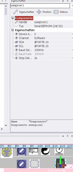

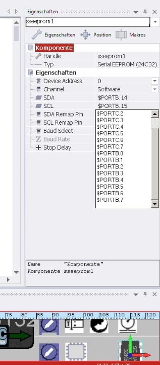

The Serial EEprom can not be addressed with FC7.3 via I2C. After calling up the program file the EEprom is configured like in picture 1, if I then assign the correct pins, I can not set the Remappable pins on the same values (picture 2). If the program then has to access the memory, the program hangs.

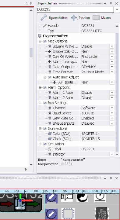

The configuration (Figure 3) is unchanged from FC 7.2, which correctly assigns I2C pins. The program will already hang on the Init DS3231.

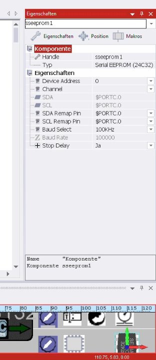

Configuration Serial EEprom see Picture4 I have tested all device addresses (0-7), no success.
With an I2C Spy, I've seen that the Serial EEprom is not addressed directly: The first entry is a BME280, works.
The following entries are from the RTC macro, this one works.
Only the serial EEprom is missing!

The component 24C32 does not work even with the changed component, I can set the software I2C pins, but the remappable pins remain unchanged on C4 / C3 and are not changeable.
For the UART components, I only change the remappable pins and the TX / X pins are tracked correctly.
In the meantime, I have temporarily written my own component for access to the serial memory, but it would be nice if I could use the existing function in Flowcode again.
