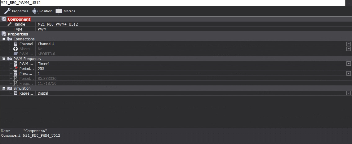

I am using the latest version of Flowcode 7
I have a test plate made of PIC16f1936 with an external 12MHz generator.
The program that outputs the 50Hz waveform at the RA0 output
At the RB0 output, a waveform of approximately 11 kHz should appear.
The actual waveform has a frequency of about 3kHz
Apparently, the PWM component shows the false frequencies
Please help.
The presented fragment is part of a larger project that works properly.
Unfortunately, the PWM generation does not work
Justin

Re: Problem with the PWM waveform frequency for PIC16f1936
So you not using an external crystal?
If you are your Configuration settings are wrong.
You should have HS Oscillator selected.
Have you completed a 1 second test?
I know you said other parts are working but its always worth doing test.
Its the first thing I do when starting a new project.
Just in case there was a PWM bug and sice been fixed, have you downloaded the latest updates from here?
Just to add to what Martin said
from my calculations with the timer period you are running as the source of the PWM will give you the 11Khz as you mentioned however the Duty cycle
resolution at this Frequency and Clock Frequency is 10 bit (0 -1023) I think you should use the makro setDutycycle10() ,then 50% duty cycle will be 511.
and 100% will be 1023 , I have modified your Flowchart can you please try it at least you will have a better resolution on your PWM
Regards QMESAR
Regards QMESAR

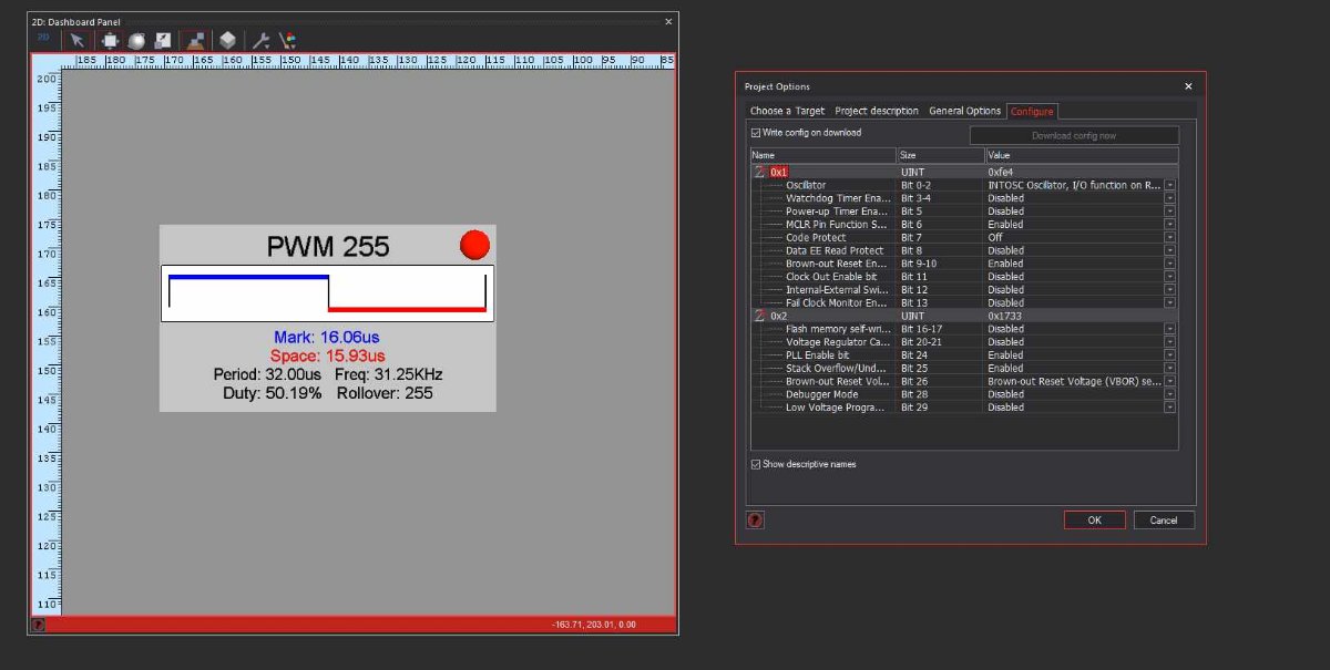

Dear Friends
I am asking you for quick help.
I introduced the updates that Ben recommended.
I changed the generator to an internal 32000000Hz (PLL ON). Attaching a new file
The 32MHz clock works ok because RA0 is the correct frequency.
PWM output instead of 31.25kHz is only 2kHz
