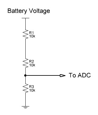

well one solution for measuring the Voltage is by using 3 Resistors in series (Small tolerance as 1% or smaller) tapping of from the last Resistor into the adc will give you a range of input Voltages 0-15V and 0-5V at the adc there you have your Voltage.
for the Current you can use a small tolerance small value shunt resistor in line(ground side-Low side sensing) with a gain amplifier stage that outputs a Voltage proportional to the current flow or you can use a Hall sensor type wich give out the voltage proportional to current now you have V and I just do the math for P . I think this is the easy way to do it :D
