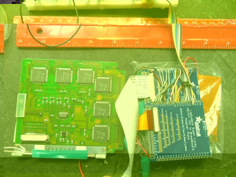

I have an expensive oscilloscope with a fading and obsolete 240x 240 pixel LCD graphical display. As 320 x 240 displays are cheaply available for Arduino and Pi use I am thinking I can get one of those and use a PIC as a protocol converter to read the existing display data and translate it to something the new display can use with just 240 x 240 of the screen.
If a PIC is synched to the row sequence and clock and reads all the 4 bit parallel column data into a 60 x 240 array it will have the complete map of the pixels. Or parse the 4 bits and save it all in a 240 x 240 array with each entry either say 1 for pixel on and 0 for pixel off. Somehow can that then be output on I2C or SPI to the new display? Or a parallel i/f is possible if it is necessary for speed. I can’t see a Flowcode macro that dumps an array onto the screen as most are for drawing lines, images etc. The help files says “Bit banging this display is possible but may be slow”. Is this what I am effectively trying to do?
I guess it may be necessary to have 2 copies of the array, one being saved into and the other being sent to o/p.
Anyone attempted something like this before?

I’ve more time now due to covid lockdown so I made a guess and got it right. I briefly got a vague approximation of the correct display with the nearly right graticule lines and scope trace but garbled text and numbers. I don’t understand that as it’s not like a I2C/SPI type display where you send it codes for each character, which it can misinterpret. I am just sending it a raster of 0/1 on/off commands for all pixels. So why does it get lines right but not text? One possible explanation is that at 2 MHz data and 70Hz refresh rates it may be on the limit of what the display can accept so it garbles some of the data. The attached spec implies a 1.3 MHz max. Only way round this would be to store a frame in a PIC and output it more slowly as say halving the data rate would not be that visibly different on the display, even on fast moving scope traces.
I chose this monochrome Hantronic 360 x 240 display (Datasheet for a similar one attached) as it’s interface is identical on paper to the scope’s output so no protocol converter is needed unless I want to stretch the image to fully fill the display. The displayed area is now less than 50% of the original area as the new display is smaller (would not fit the case if any larger) and I can only populate 240 x 240 pixels. But both old and new have the same number of displayed pixels so it should be as sharp.
The badder news is that I seem to have shorted a wire and killed the scope's clock pulse so now no longer have a working display. It’s the inside of the main 208 pin processor that has failed so no chance of changing the chip. It does output a few pulses but not nearly enough.
I think I could recreate the clock using the data nibbles into a PIC based phased lock loop. I.e. I read the nibbles into an interrupt and every time one changes it indicates that a clock pulse is needed to make that nibble write into the display. As the nibbles won’t change if there is a white or black block I can maybe guess the blanks as I know it’s about a 2Mhz clock rate. All I need to do is shift that 2MHz up and down say 5% based on the nibble changes and get it timing correct wrt the data. Anyone tried this? I can foresee problems though as a scope trace I posted above shows that the clock pules come in pairs with random gaps inbetween. So if I regenerate an evenly spaced 2Mhz pseudo clock it's not always going to line up with the incoming data pulses
The scope's and new displays's parallel interface is 21 wires wide as follows:
D0 - D3. 4 bit data nibble to fill 4 columns on 1 line at a time.
CL2. Clock pulse at 2Mhz. Scope trace of it is in a post above in doc "Scope clock pulses.pdf". Moves data along four columns for each clock pulse. Confusingly it’s only there 50 % of time as, after writing one frame full, it pauses for about the time it could take to write another. Why? To enable the scope to fill its RAM with the next frame?
CL1. End of line/row pulse. Jumps display to lines 2,3,4 till 240. I.e. the data starts the frame at columns 1-4, row 1, then column 5-8, etc. After column 240 it jumps to row 2 back at columns 1-4.
FLM. Start of frame
M. A slower 50% mark space signal to alternate the bias voltage polarity to give the AC bias.
Plus less difficult to deal with ones:
LCD bias voltages
3.3V power supply
Ground wires.
DOFF. Turns display on/off. Not sure why the scope outputs this as display is never off unless all powered down. Will just tying it to 0 or 1 do?
Temperature. The scope display outputs a display temperature signal but Hantronic doesn’t use it. I suspect it’s used to adjust the contrast voltage slightly to eliminate temperature effects.
Contrast. The scope outputs a menu controlled contrast signal but Hantronic doesn’t read it. I now have a manual trim pot but could later read the scope output to adjust the Hantronic.
The advantage of this interface is that it is fast. The minute I use colour displays or I2C/SPI interfaces I fail to see how my coding skills and Flowcode could process the nibbles and incoming clocks fast enough in a PIC to fill the new display, as some sort of video RAM will need to be filled to convert what comes in into what is needed to go out. But I can see how I could use a PIC to read a few nibbles and average them to work out how to crudely interpolate columns on a 50% stretched display. E.g. if the incoming data is columns 1, 2, 3, 4 the outgoing becomes 50% more columns like 1, 1a, 2, 3, 3a, 4, etc. where 1a is the average of 1 and 2 plus the pixels above and below 1 and 2. So if more than half in that area are black 1a becomes black too. It does not give an even interpolation as there is no 2a, so a straight diagonal line would become slightly stepped, but might look OK.
Front and back views of old and new displays together here. You can see the large central "burn" on the old one which causes it to be almost unreadable. The plastic bag on the new one is meant to prevent shorts between the display's PCB and my interface PCB but did not save the clock line.
- SDC18537.JPG (262.48 KiB) Viewed 18196 times
- SDC18536.JPG (279.8 KiB) Viewed 18196 times
