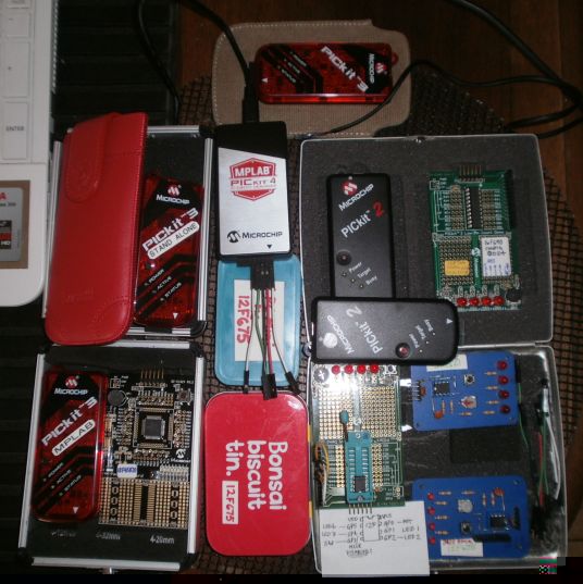

Based on my experiments so far;the PK4 is a 'broken' piece of hardware...the programmer to go/SD card feature
was promised two versions ago,when the PK4 was first advertised; it was one of the two reasons i bought the new model
and is still absent from IPEv4.20...
I've been in contact with microchip over this only to recieve a ' i'm out of the office for 5 days ' message;and as they are currently running ther Arizona 'Masters' event...i don't expect much will be done before i send the B.....d back :(
I have installed the long-awaited new IDE/IPE and the same bug in v4.15 has all 'travelled' into 4.20...
PICKit 4 won't release the clock pin after programming the 12 series chips
You have to pull the 'PGC' connection to get the circuit to run. applying 'external' power makes no difference at all.
as soon as the PK4 is plugged in to the programming connector it disables the I/O on pin6.
However, if you plug the programmer into the board, after using a 16-series chip without resetting the chip type or clicking on 'apply' the board is powered and runs properly...so it seems it is a software bug.
but you obviously WON'T be able to program anything...
My results so far:-
12F675/Low pin-count dem PCB...NO..PGC pulls down I/O on chip pin 6 disabling the LED from being driven
12F1572/(another newer) low pin-count dem PCB...NO, as above
16F690/Low pin-count dem PCB...OK no problems
18F45K22/PICKit3 Debug Express PCB..OK no problems
12F675/My 'clone' LPC boards (18 months without any problems)..NOT working with PK4..same problem (PK3 PK2 both OK)
FunN annd gAymZe...

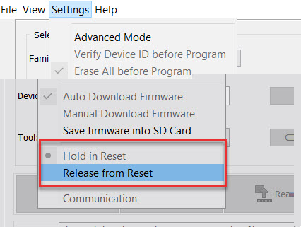

hackinblack wrote:PICKit 4 won't release the clock pin after programming the 12 series chips
Just checking if you are using the IPE SW to program you have to set the release option ,
I never had this problem of the IPE not releasing the pin.

no,i checked that;as well as the pull-up/down an resistor value options on the clock and data lines
(under ISP settings) nothing stops this annoying problem. :x

Ok just take note I do not have a PK4 however I had these no release problem with IPE if the release from reset are not selected on PK3
I just thought to mention it there is probably a error with the PK4 which MCP should solve
