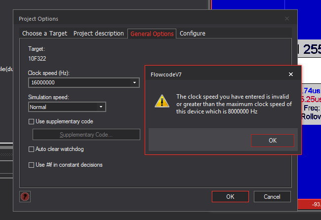

I have just seen your recent Vlog 7 about uC32 PWM on FC8:
http://www.flowcode.co.uk/blog/flowcode- ... -with-pwm/
and being inspired by it I wanted to try a simple test with that code with PIC10F322 and PWM in FC7.
The PIC10F322 Datasheet Oscillator Module - page 24:
http://ww1.microchip.com/downloads/en/D ... 01585D.pdf
says that it is possible 16MHz clock with internal oscillator and of course I have test that in the past and it works up to 16MHz.
The FC7 does not let me 16MHz. It says 8MHz is max. allowed.
Can you help to correct that error?

The Osc speed selection dropdown does stop at a maximum of 8Mhz,which is wrong for this chip.
it's capable of 20Mhz clocked PWM. But your settings for the osc type are wrong..
you have ' EC on CLKIN pin ' selected...not the internal HS osc.
(18.96 KiB) Downloaded 2833 times

Hi Viki,
Whilst waiting for Matrix to change the maximum speed,
If it's urgent you can modify maximum speed within fcdx file.
For 64 bit windows 10F322.fcdx can be found in:
C:\Program Files (x86)\Flowcode 7\FCD\PIC\
32 bit windows
C:\Program Files\Flowcode 7\FCD\PIC\
At the top of 10F322.fcdx you will see:
<root>
<device name='10F322' product='PIC' family='10F' bits='8' >
    <clock max_speed='8000000' master_divider='4' default='8000000' />
Just change the speed, overwrite the original 10F322.fcdx then you can use the Reload option:

It’s difficult to be an expert on every PIC chip, and people only tend to answer if they are fairly sure of the answer.
The datasheet seems to indicate that the maximum clock is 16MHz, despite the PWM table including 20MHz.
You are free to edit the FCD file for this device to extend the max frequency to 20MHz, but whether the clock in can be driven at that rate I don’t know.
edit: Ben has just pointed me in the direction of page 158, I didn't get that far earlier :lol:
Re: FC7 PIC10F322 – Oscillator Error
No FCD file editing should be required.
If VDD <= 2.5V max clock = 16MHz
If VDD > 2.5V max clock = 20MHz
The clock speed in the project options can be selected from the drop down list or the value can be typed in directly. e.g. for values not in the list.
(10.67 KiB) Downloaded 2783 times
Just been chatting to Leigh and here are the 10F FCDs complete with the correct max clock settings.
