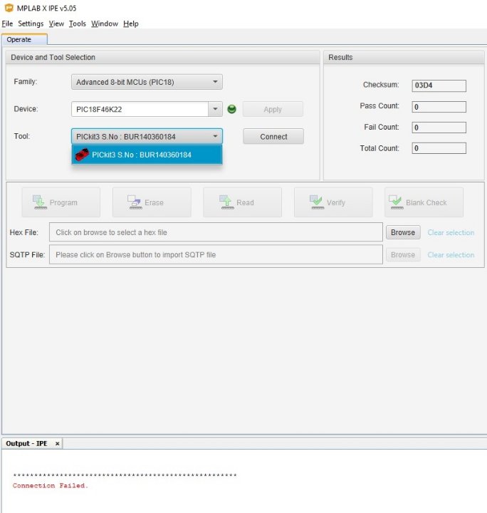

Hello Medelec and thank very much for your reply, i installed Mplab X only IPE but i am unsure of what you want me to do.
do you want me to set up the Pickit3 within the IPE software(i am not used to the software), or refer to the IPE destination and parametres in flowcode programmer setup? i tried this but no luck
in IPE i can se the Pickit and there is a green lamp so i suppose that there is some sort of connection to the Pic but it reports errors when i press connect.

Re: Pickit 3 flowcode 6
Your settings within compiler options look correct.
You won't be using IPE, it will be Flowcode that's accessing \mplab_platform\mplab_ipe\ directory
However if you can't manually connect PICkit3 using IPE then Flowcode won't be able to connect either.
What you can see is probably caused by PICkit3 not in MPLAB mode, i.e was used with the PICkit3 stand alone programmer?
One thing to try is unplug PICkit3 USB, hold the black button in, then with button pressed in connect USB lead.
Wait until STATUS briefly flashed then release black button.
Now within flowchart compile to chip.

Wuhuuu :D that did it Medelec thanks a lot for your fast reply and always great support.
I just restarted the pc and did the thing with the black button on the pickit and it worked after that with the new Mplab IPE settings
