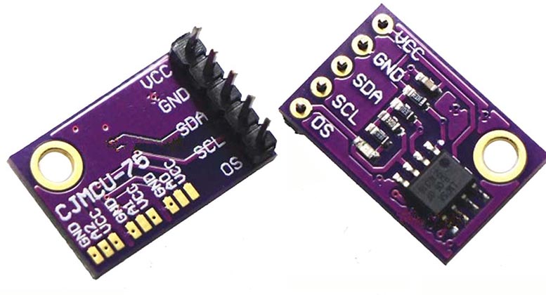

Is it possible to use CJMCU-75 temp module with LM75b component?
And if it is:
- how to configure the i2c pads on this module to get the i2c address correct?
And if it is:
- vcjmcu75.jpg (70.12 KiB) Viewed 9313 times
Re: CJMCU-75 temp module question
I cannot say 100% as the module has a LM75A instead of the LM75B but it looks like it should be compatible and work correctly.
Currently the address should be:
A0 = VCC
A1 = GND
A2 = GND
Taken from this line of the C code.
A0 = VCC
A1 = GND
A2 = GND
Inside the Initialise function.FCR_RETVAL = FC_CAL_I2C_Transaction_Init_1(0x49);
We should be able to add a new property to the component to allow the user to control the address.MX_UINT8 FCD_0e021_LM75B_DigitalTemperature1__Initialise()

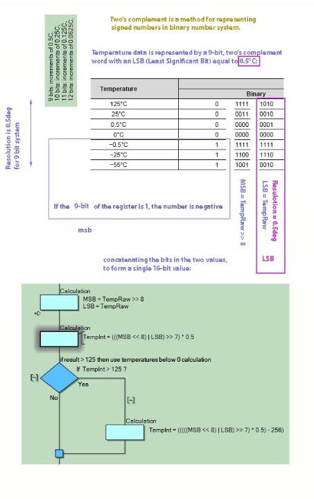

- Posts: 367
- Location: South Australia
- Has thanked: 45 times
- Been thanked: 63 times
By using medelec35 advice I have checked the LM75 datasheet.
The hard to understand part was about the two's complement format.
I need more time with that.
For now I have stopped at this diagram (please correct and add more info).
- LM75_diagram1.jpg (65.46 KiB) Viewed 9218 times

- Posts: 9521
- Has thanked: 2585 times
- Been thanked: 3815 times
You edited your post as the post I'm referring to where the flowchart is wrong is just above this post.
refer to my post with date and time of:
Fri Oct 12, 2018 11:14 pm
Fri Oct 12, 2018 11:07 pm
- Posts: 9521
Yes The flowchart now looks correct.
You have got TempInt >125 instead of TempInt <0
It would be better if corrections are on a new post.
Does it work now?
Does it work now?
