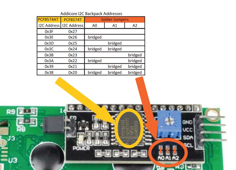

Re: I2C LCD printing strings
With NO jumper on A0, A1 , A2 the address is x3F (or 63 decimal) - this works 100% for me.

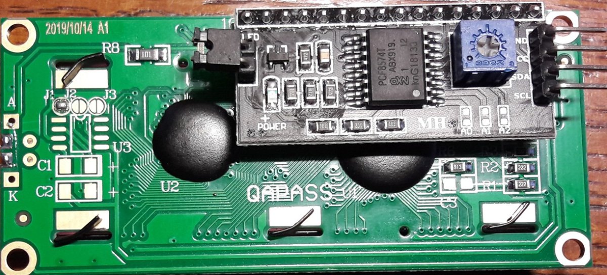

The basic adresses of this expander are found here. And for the record, it does work with the LCD I2C (LCM1602) component that you can find in Flowcode 8.
If there are no bridges on the expander board, then the adress lines A0 to A2 are high. In my case this meant that the standard adres is 0x3F (63 decimal).
I'll post an image here of the 'differences' in expanders. (PCF874T or PCF8574AT, where I use the last one)

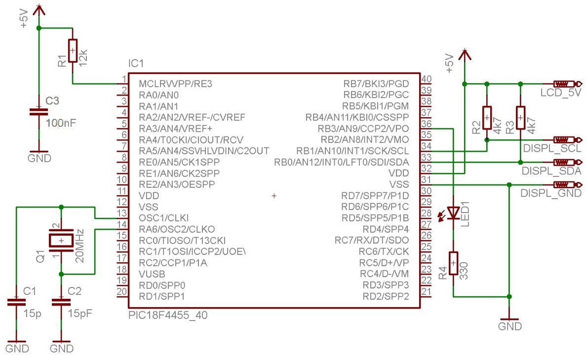

Hey
Can anyone help?
The LED flashes three times. I can't get the i2C display to work with the 18F4455.
I put the hex file in the microcontroller with a pickit2.
Thanks in advance

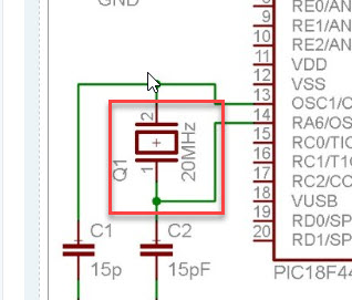

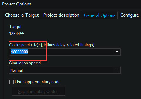

You schematic shows a 20Mhz clock your SW is setup for 48Mhz ,and the configuration looks suspicions to me
if this is the actual state of your project 20Mhz clock the LCD will never work as the baud rates are incorrect
thanks for your response.
If I change in flow code 48MHZ to 20 MHZ then the LED flashes too fast and the display still does not work.
If I use 48 MHz de led flashes correct.
Indeed I think the error is in entering the "project options"
But I can't find the error.
163/5000
When I use the i2c board with an arduino, I don't solder the jumpers either and then the board will work.
That's why I don't think the problem lies with the board.
I suspect the problem lies with the microcontroller setting.
