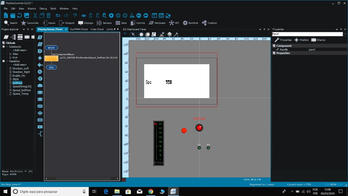

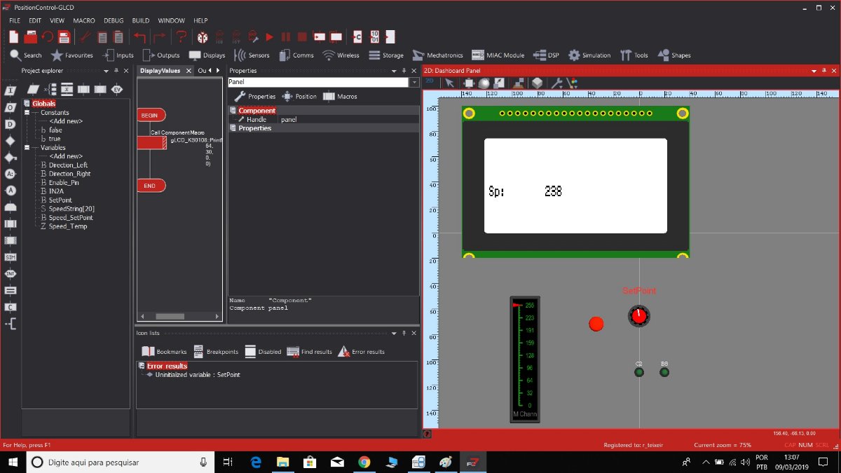

Hi all,
Iam trying to simulate a program using the component KS0108 within flowcode V8, But I keep on getting a different view on the 2D dashboard, and the readings are overwriting. I've already updated the components, but the errors keep on happenening. As you can see on the V7 flowcode the images are perfect and V8 is not.
Can somebody please give some orientation
Rod

I forgot to upload images :D
Re: GLCD - Component - KS0108 - Flowcode V7 and V8
Many thanks for letting us know.
I have found and fixed the problem now and the latest files should be available via the update system.
