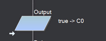

I have an issue with the Output Icon on PIC18F26K80 RC0 and RC 1 I never get an output on these pins
I then used MPLAB and toggel these pins in Code working fine no problem the HW it seems to be something with the FC component
on PIC18F26K80.

Just as an info for others the P18F26K80 is a bit tricky with the configuration bits to get the RC0 and RC1 pins to work as digital you have to set
the SOSC Power bit to Digital :wink:
