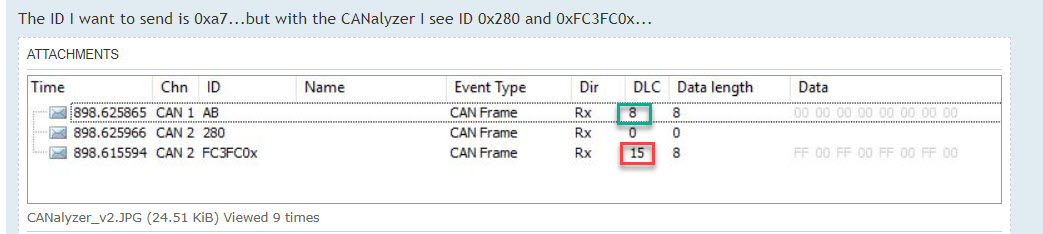

Re: dspic33ep128gm604 CAN BUS Problems
Hello Benj,
ok, can you send me your current CAL_CAN file?
With the CAL_CAN file from your post in the other chat is transmitting with Ch1 ok, Ch2 sends wrong data and 2 different ID`s and I send only one ID.
The ID I want to send is 0xa7...but with the CANalyzer I see ID 0x280 and 0xFC3FC0x...
Here's the current CAL file.
Hi All,
Just my 2 cents from a past problem very similar to this is that if you look at your CANalyser you will notice you see 1 extended messgage ID with a DLC (Data length code )of 15 this is a PC CANalyser Driver issue specially if you use win 8 or 10 ,There is no way the PIC can send a DLC of 15
I had this issue and it drove me nuts until I found the correct driver(this was with PeakCAN though
I not saying this is the issue however the DLC of 15 is suspicious .
Regards QMESAR
Regards QMESAR
Hi QMESAR,
thanks for your help. You`re right, dlc 15 can not be, but i think the CANalyzer shows this because the data from the pic are not plausible.
(i`m using Vector CANalyzer)
With the last CAL_CAN file from benj is transmitting ok now. The Problem now is the receive part...
Best regards
Daniel
Best regards
Daniel

I've got hold of some hardware (nicked off Ben
All seems to be well as far as I can see.
I've successfully sent a standard ID message from one channel (set to "standard") and received it OK on the other channel set to "standard & extended"
I've fixed the GetRxIdent such that it uses the IDE flag from the received ID (rather than the component property mode)
So if you use the attached updated CAL file you will get the correct received message ID
The only thing we cannot do at present is dynamically change the transmit ID mode of a channel,
that's something I could have a look into, depending upon if you need it?
You made a comment earlier that you need to receive "standard" and "standard & extended" ID messages,
but send them on channel 2 as "standard & extended",
is that correct?
Leigh

Hi Leigh,
many thanks for your help.
i have tested it, it works the way you say.
"The only thing we cannot do at present is dynamically change the transmit ID mode of a channel,
that's something I could have a look into, depending upon if you need it?"
=> That would be awesome
I`ve many projects with CAN networks in cars and often have to modify data from a control unit which receive the rest of the car. I seperate the bus for this, thats why i have to put through many messages (with standard IDs and also extended IDs) to the other channel.
In short I have to receive standard ID and extended ID on both Channels and send them as i received on the respective other channel. (CAN to CAN gateway)
I hope I could explain it reasonably well with my bad english
Many thanks in advance
Daniel
Daniel

Hi Daniel,
You could force the sending of a standard ID with the following C code, used instead of the SetTxIdent
MX_MEMBUF_2[0][0] = (FCV_CAN_1_RX_ID_B0) << 2;Re: dspic33ep128gm604 CAN BUS Problems
Hi Leigh,
everything works perfectly now!
i did the same with "MX_MEMBUF_1[0][0]" for sending on CAN 1.
And when ID > 0x7FF => i use the component "SetTxIdent"
Thank you very much for the your great support
Daniel
