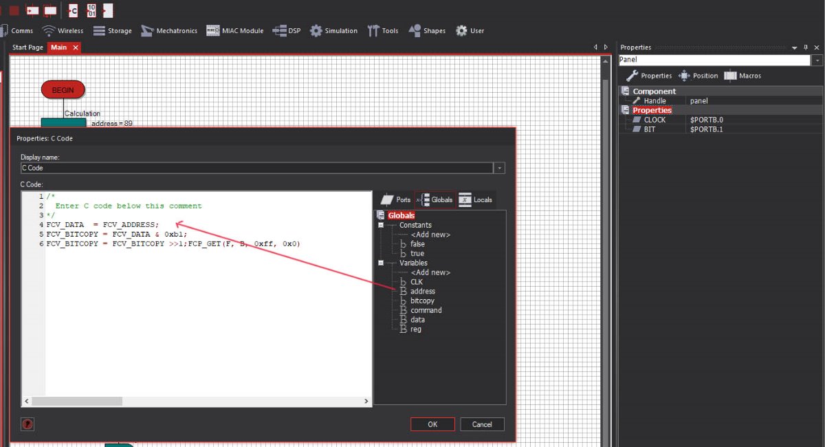

Hi Everyone
I just want to share this with you. I have been trying to get to grips with FC7 & 8 C code environment. I have discovered that, by simply clicking onto and dragging the variable across into the C icon space creates the correct syntax. And it compiles correctly too.
FC7 FC8
FC7 FC8
