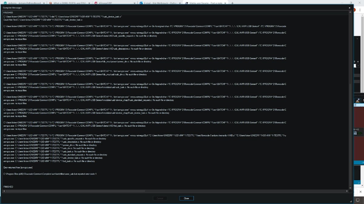

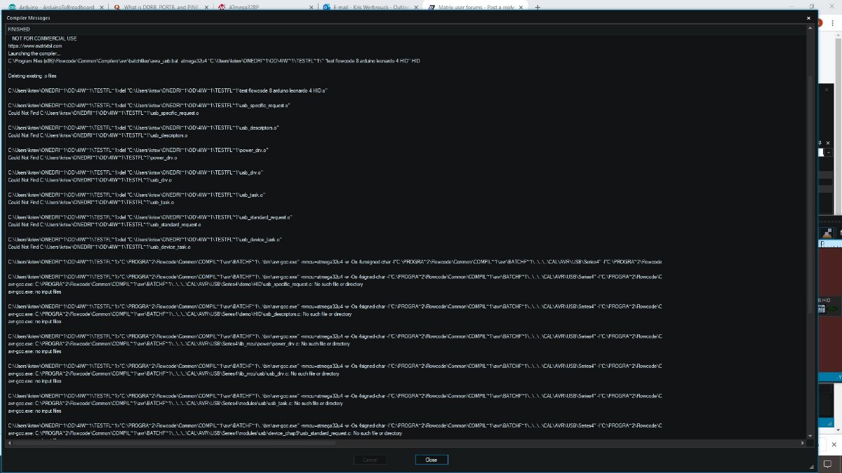

It doesn’t work
- settings.jpg (61.84 KiB) Viewed 7262 times
- USBHIDPage1.jpg (129.97 KiB) Viewed 7262 times
- USBHIDPage2.jpg (141.09 KiB) Viewed 7262 times

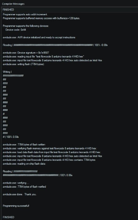

The USB HID component doesn't work. There is no error with the compiler.
I use also the built in led of the arduino. With the new compiler options, it doesn't work.

I've made some minor changes to your program and it's now working well for me.

Great glad it's working for you now.
I think it was mainly down to the delay before the initialise to give the PC time to see the bootloader disconnect and the HID device connect.
The other delays are still required as the HID only transfers every 10ms.
