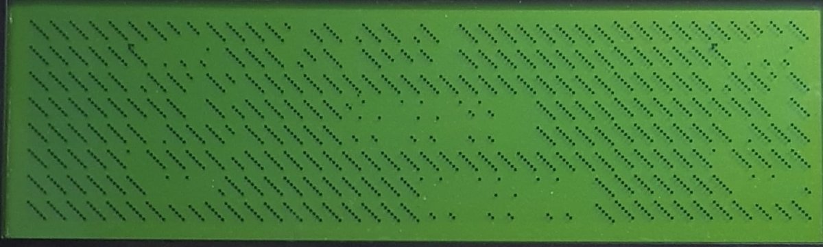

Today I got another GLCD also with T6963 and also 64x240 and the result is the same.
Interestingly, the image tends to appear twice, after the image is finished, the same image continues to start.
I attach the image from the laptop and the images displayed on both GLCD.
Image from Laptop: Image on Amber GLCD: Image on Green GLCD:
EtsDriver
- Posts: 444
- Joined: Tue Apr 15, 2014 4:19 pm
- Location: Kajaani, Finland
- Has thanked: 345 times
- Been thanked: 227 times
Re: Help with GLCD Toshiba T6963C
Is your image correct resolution?
Try inverting the colors in paint.net?
Remember to save it as monochrome 2 color bmp file.
bercioiu
- Posts: 161
- Joined: Sun Feb 25, 2007 10:56 am
- Location: bucharest, romania
- Has thanked: 90 times
- Been thanked: 34 times
Thank you for your reply.
The image is made by hand in Flowcode with circle, rectangle, etc.
