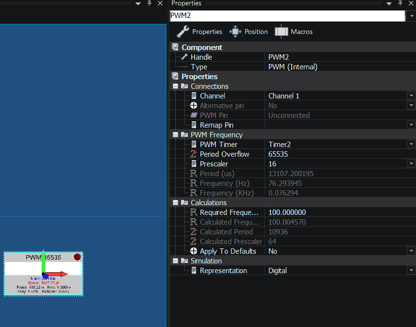

I tried to add a IPWM component and I can't asign a pin to it. It also won't compile.

Hi Chad
Have you assigned the remap pin connection in the component properties. Same goes for uart based components.
If you have already done this then please post your programs so we can investigate.

Hi Ben,
Unless I make a mistake it seems that it is not possible to do a selection for the remap on the chip in FC
Shouldn't a list open with all the possibility in FC ? if I click on the remap position
at the moment the the list box change to white color with no list or pin descriptions (empty list) :D
Pic 32MZ0512EFE064

That's what I ran into on a hand full of components that I tried.
Chad
Re: PIC32 PWM(internal) component broken
Thanks for letting us know. This one should be fixed now too.
