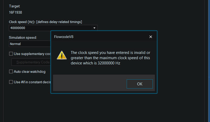

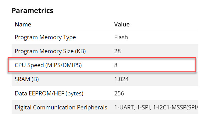

(1) The PIC161938 you can not use 40 000000 Hz a maximum of 32Mhz
look at the datasheets before ranting at FC and BEN (NOTE 8MIPS x4 = 32MHZ(MIPS) :twisted:
setting any other speeds above 32MHZ unpredictable results will be obtained
(2) You are not setting the Frequency correctly in FC flowchart as well which is essential when using softuart ,because if you did you would have noticed that FC tells you can not use this frequency
