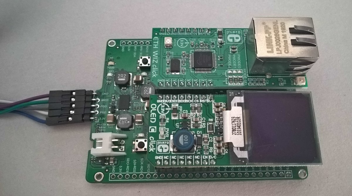

Re: W5500 question
Hi TSMroz
I'm using the W5500 on a hardware.
It's a clickboard where you can choose 2 clickboard
I choosed: place1 the W5500 and place2 a oled display
Both are working with the FC program in the attachment, I can conncet to the PC and send and get some data.
But there is a lot of this wrong in my code I'm working on it.
but soon I will improve it and see that it works with Flowcode SCADA.You may want to look at the hardware.
MIKROE-1718
https://www.distrelec.ch/de/eth-wiz-cli ... ggest=true
MIKROE-1585
https://www.distrelec.ch/de/oled-click- ... ggest=true
MIKROE-2800
https://www.distrelec.ch/de/clicker-for ... ggest=true
EMG2020-network_IF1_display_socket_server.fcfx
(40.15 KiB) Downloaded 245 times
