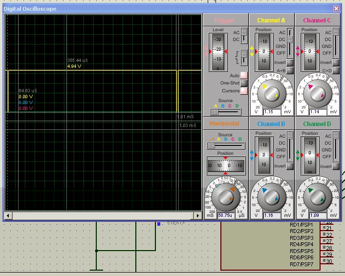

Hi khaled yasin , i think you may need to start your PWM servo experimenting using the already available
programs from this forum, it is only my opinion mind you, i think your tackling your programing the wrong way ...too many jumps... using the program length to govern the speed of pulses etc.... I have put your program into proteus and took a screen grab of the oscilloscope. You can see that the timing is all wrong.
best of luck.
best of luck.
- screen grab1.jpg (109.5 KiB) Viewed 6186 times
