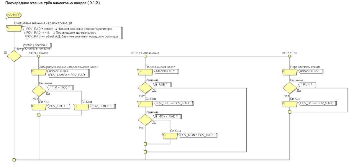

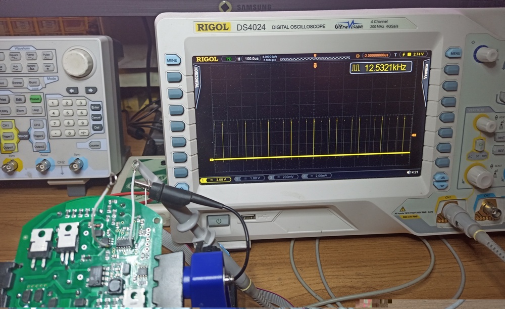

Hi Benj!
It doesn't change anything...
My version of the program works
only if I read lowercase,
I attached a photo below.
Sincerely Osta

Hi Benj!
Your recommendation doesn't work!
As before, the senior level is not readable.
Only the lower-level ADC is read.
Above is a picture of the lowercase operation
What to do?

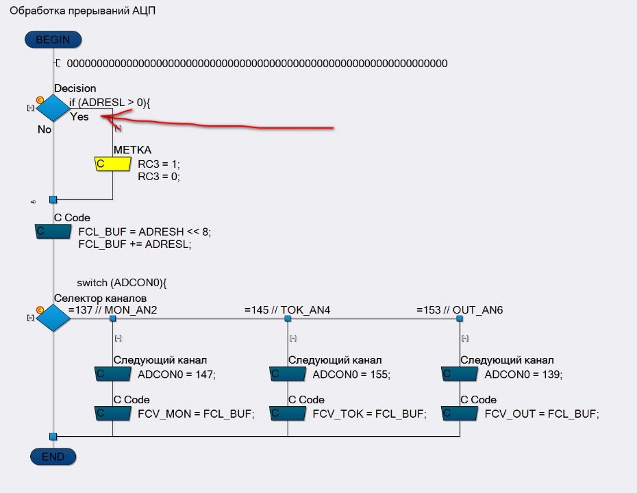

Post by Osta »
The macro does this.
And I need to start the ADC and get out of interrupts as soon as possible.
Go back for the result, change the channel and exit again. This is a cycle that takes less time
, measurements run in parallel and there is no reason to wait for the result in interrupts.
Code snippet
Code snippet
