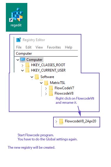

Re: Flowcode 8 crash
I had the same problem on 2nd April 2020.
Finally I understood that the problem is in the corrupted registry.
After I renamed the registry the FC8 has created a new one
and I have never had any problems.
- RegistryProblemFixed-1.jpg (41.76 KiB) Viewed 15285 times
THX Victor,
I will check your solution.
I had the Problem already twice.
I deleted the Reg Key after the first case and installed FC8 again. This was running until yeserday.
Then i deleted yesterday only the Reg Key...
...until now FC8 is running again and there is a new Reg Key again.
As far as I remember the crash happend shortly I was playing with F2 and F3 Zoom Funktion.
Then I selected a decision Icon.....
BR
Dirk

Thanks for the info. Can you please ensure you're using the latest version of v8 (v8.2.2.15).
- (33.67 KiB) Downloaded 1041 times
