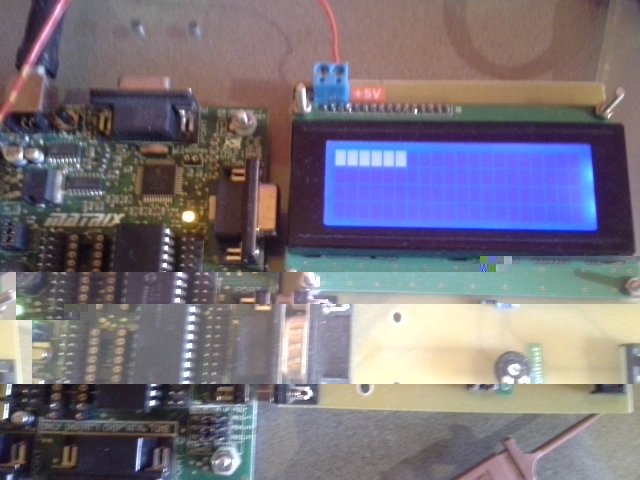

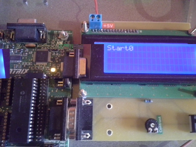

With the ESP initialised
LeighM wrote:They probably will cause an issue, particularly if flow control is on, try this again ...
Try the component debugger window and expose component tree tickbox, this will let you go down through the properties of nested components.
The one you're looking for is the CAL UART.
Check that the flow control property is set to off.
But also change the flow control properties away from port B
btw.
Regarding my previous post, could you just confirm that the current issue is that the display does not work when the WLAN initialise is in the Flowchart?
Did moving the Interrupt make any difference?
Sorry, I can understand your frustration, but the more specific information you give us the quicker we can help.
With the initialisation macro:
Without:
Without
Without

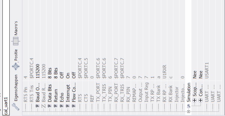

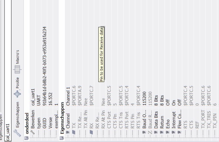

The properties:

Thanks for the images.
I presume that the property changes have now fixed the differences with RTS/CTS on PORTB, between V6 and V7 C code?
I cannot see any reason for what is happening.

In the images that you posted of the properties, it looks like you have successfully changed the PORTB to PORTC
So my question was, is the C code now fixed? i.e. before you had ..
V7 = #define MX_UART_CTS_PORT_1 portb
V6 = #define MX_UART_CTS_PORT_1 portc
Does the V7 generated C code now have portc too?
If not, this might still be the cause of the issue.
