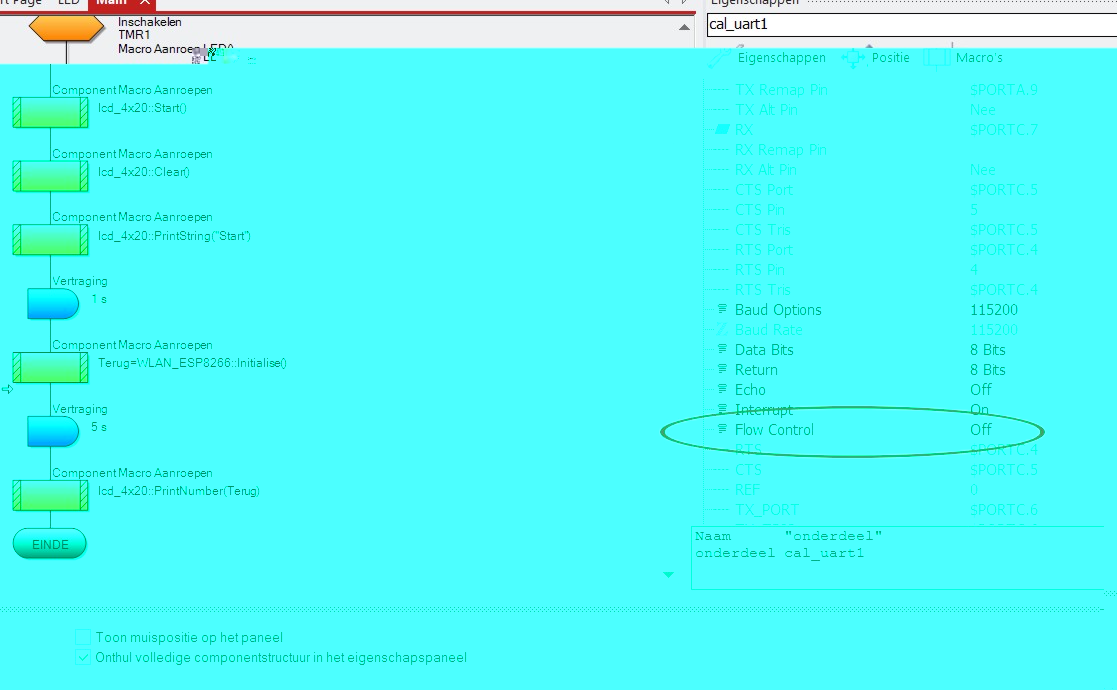

I have made a flowchart that does following.
1- start the LCD
2- print "start"
3- initialise the WLAN..
4- wait the response.
5- wait 200ms
6- check the response and print the result.
The LCD shows nothing from start.
If I remove the "initialise" macro, the LCD works.
Something is wrong, just can't get what...

Re: 18F4550 with WLAN_ESP8266 doesn't work
Try the component debugger window and expose component tree tickbox, this will let you go down through the properties of nested components. The one you're looking for is the CAL UART. Check that the flow control property is set to off.
A while ago it was being set to on behind the scenes which was causing problems but this should have been fixed a long time ago. Unless for some reason it's come back. If it's already set to off then you don't have to worry about it but it sounds like something is messing with the LCD connections.
After you print start to the LCD try adding a delay so you can read the message before the ESP initialise macro is called.
Post by MJU »
Benj wrote:Hello,
Tried it.
Flowcontrol was OFF.
Print a text onto the LCD
Added a delay of 5 sec before initialise the WLAN.. component.
Added another delay after intialise and then tried to print another thing..
After sending this to the PIC, same problem.
Just some white blocks on the LCD.
No readable text.
After removing the WLAN initialisation from the Flowchart. The LCD works..
Same problem..

Using the lastest files.
Flowcontrol is OFF:
Here is the file:
ESP8266 met 1 seconde timer.fcfx
(11.02 KiB) Downloaded 269 times
No avail..

I disconnected the device (the ESP).
Even then the problem stays from the start of the program.
There isn't a power issue because the same board works:
- when the ESP is connected but not initialised
- With FC 6 programs..
