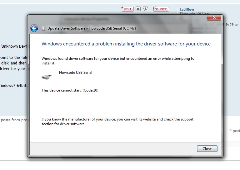

If I uninstall the USB serial, it indeed shows up in other devices but as 'Unknown Device'.
What bothered me was that when I attempt to install the driver, and point to the folder with the .inf , Windows never recognized it and said 'driver not found'.
However, if I ask it to list compatible devices, select USB serial, 'have disk' and then point it to the .inf , I get an error:
"The folder you have specified doesn't contain a compatible software driver for your device. If the folder contains a driver, make sure it is designed to work with Windows for x64 based systems."
So it seems that this auto-generated driver is incompatible with my Windows7-64bit.

Update: the error I mentioned above is when I attempt to manually install the Flowcode-generated driver for a 'Universal serial controller'.
When I attempt to install it for a COM port, I get a list including Matrix MultiMadia, then select "Flowcode Serial USB' then navigate to the .inf and ask it to install that one, I get this error screen:
jan

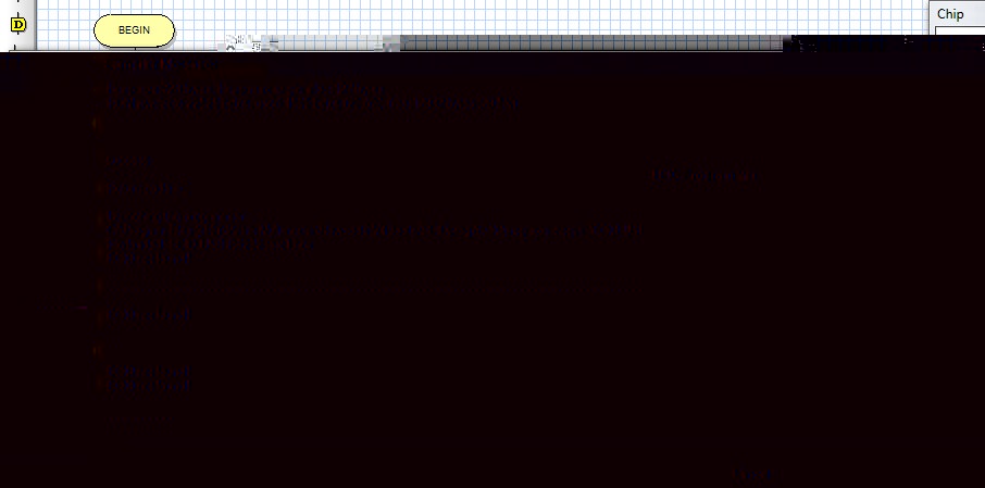

Just to exclude anything wrong with my particular EICO unit or compilation/programming setup:
Can someone please look atv these screen shots from 'Compiling to Chip'.
This is with the EICO connected. At the end (screen eico-1) the message appears to press the button on the EICO.
jadiflow
Flowcode v5 User
Posts: 273
Joined: Thu Apr 17, 2008 9:59 am
Has thanked: 19 times
Been thanked: 16 times
Re: serial USB doesn't start
Post by jadiflow »
Then I press the button on the Eico and the next screen appears:
The next screen then appears (eico-2):

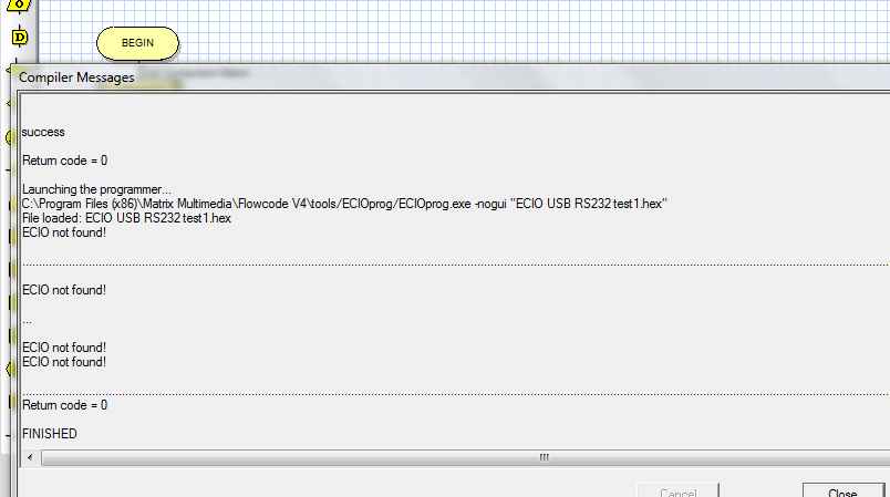

After that, I click 'Cancel' on the message box, and the eico-3 screen below appears.
You see that there are several lines 'eico not found!'.
This may be perfectly normal, I don't know, but it would be nice if someone can confirm or otherwise whether this all looks normal.

This is not normal. You should never have to press cancel. Once the programmer detects the ECIO the window will disappear by itself.
Regards,
Jac

OK. Found and downloaded the EICO driver package.
There are three executables in the package:
Matrix_EICO_Driver_Install (amd64).exe;
When running, this gives the error:
'DPInst does not execute on your current Operating System'
Matrix_EICO_Driver_Install (ia64).exe;
'Not compatible with .....'
My operating system is W7 Home Premium.
Now what?
jan

Update:
The driver install DOES run in Vista compatibility mode.
Installed, and now EICOprog.exe recognises the EICO.
Seems fixed.
