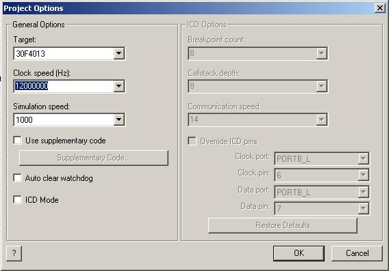

Hi, I have been using the dsPIC for a few months now in the setting shown in the screenshot.

What crystal are you using? Is it the 12MHz one supplied with the board?
In your project options you are setting the speed for a 12MHz oscillator so the HS mode of operation should work correctly.
Page 142 of the device datasheet gives a table of all the oscillator modes, EC and ECIO modes are for external clock which is not what you are using on the EB064 board.
I would recommend performing a 1 second LED flasher test on the hardware to confirm your hardware and Flowcode are setup correctly to work together. Once you have this correct your RS232 baud rates should be spot on.

The XT setting is for clock speeds of 10MHz or less on a 16-bit PIC. The HS setting is for clock speeds higher then 10MHz.
The HS2 W/PLL 4x use the onboard PLL to multiply the input frequency. This one divides the 12MHz input by 2 and then multiplies by 4 to give you 24MHz. You would then put 24000000 into your Flowcode clock speed setting to allow delays etc to be correct on the hardware. I would advise playing around with these setting to get the best speeds from your device.

Have you got the 24000000 as your clock speed in the project options menu? Also have you performed a quick 1 second flasher test to ensure the delays are correct? You may have to enable to clock switching and clock fail safe monitor to allow the PLL setting to work correctly at 24MHz.
Once you have the clock setup correctly in Flowcode so that delays are correct on the hardware it should calculate your baud rates correctly for the UART.

As 24MHz is not available (20MHz and 40MHz is the nearest). In version 4, I chose 48MHz with HS2 PLL 8x. I just tried 1 second led flasher, it works precisely. But rs232 macro still fails. The macro is an EXACT copy from a working file.
Re: dsPIC30F4013 error
The input field is a text box which you can type values which are not already in the list. The clock will have to be exact for the baud rate to be calculated correctly.
