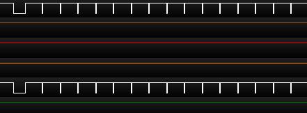

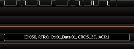

Right there is data going out from the internal CAN component but something is obviously not right.
Here is a trace from the MIAC.
And here is a trace from the internal CAN
Hmm....
