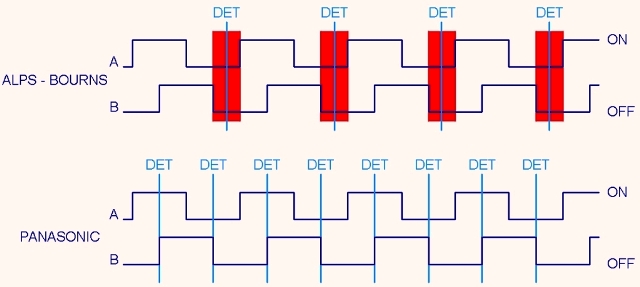

I just looked at the datasheet of Jorgen's encoder "Bourns ECW1J-B24-AC0024". If i have correctly read its PART NUMBERING SYSTEM, i think - Jorgen please correct me if i am wrong - that is a 24 DETENT equiped encoder. From my experiments CONTINUOUS rotary encoders can be easily programmed while DETENT equiped encoders are a real headache.
@ Jorgen: In the link that gave you Martin, you can find some useful fcf codes to try your encoder. According to datasheet its PATTERN is the same with this of ALPS, so you could try directly the related fcf file.
Now regarding detent equiped encoders, those that have the pattern of Panasonic are most easily programmed from those that have the pattern of ALPS and Bourns. Please look carefully in the atached schematic. There are also ALPS encoders with the same pattern of Panasonic.
Encoder Patterns.jpg (74.58 KiB) Viewed 19834 times
Best Regards FOTIS ANAGNOSTOU

One of the dominant efforts of all manufacturers of micros, is to incorporate into these as much peripherals as possible thus minimizing the need of use external components. In this direction have been incorporated e.g. the internal pull-ups. So it should use them.
On the other hand, the detent equiped encoder is constructed under the logic to offer a sense of the "clicks" of a traditional rotary switch rather than a potentiometer or dialer; i.e. the feeling that each "click" is equivalent to ONE state change. So the IOC interrupt is only needed to one of the two switches of encoder. The second switch serves only in the evaluation of the rotation direction. In the picture it is evident that the pattern of Panasonic is more distinct, more clear than the pattern of ALPS - Bourns. The imaginary line of each detent coincides with the middle of ON - OFF pulses produced by switch A. Thus, when the encoder is rotated clockwise, the High to Low transition of switch A clearly coincide with the positive edge of pulses produced by switch B . When the encoder is rotated counterclockwise, a High to Low transition of switch A - again - clearly coincide with the negative edge of pulses of the switch B. That offers the ability of the use of only one interrupt making the whole process simplest.
In a comparison the detents of ALPS - Bourns encoders are located at the negative edge of pulses of both switches A and B and even in a short distance from transition points. So, it's some hard to evaluate the direction of rotation using the falling edge IOC interrupt - remember please that the internal pull-ups are enabled - without mistakes.
Thanks for your attention
