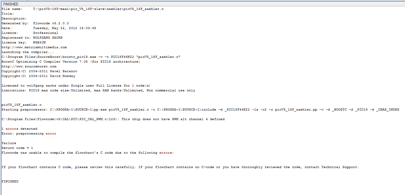

- Posts: 714
- Joined: Wed Jan 31, 2007 12:41 pm
- Has thanked: 1 time
- Been thanked: 26 times
Re: 18F46K22 PWM
Hello Benj
Never bevore I show the error for ch4 and ch5......
Regards Wolfgang
Regards Wolfgang
- (23.01 KiB) Downloaded 807 times
