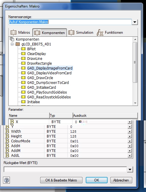

Re: MX031 - Multimedia Files on 4D Eblocks
Hi Ben,
Hello together,
success Problem solved it is working
Here is what must be done:
1. Choose the following 4D Graphic Composer mode
Attention the SD will be formatted during this opperation. Make shure you selct the correct drive!!!
2. In your working Folder you will get the following TXT file (the Folder were you picked you Picture)
My working Folder in this example was on the G: drive as you can see. In the drop down box above you must select your SD Card for the display:
File "CB Logo.jpg" (CB Logo.jpg)
Sector Address 0x000000
X = 0 Y = 0 Width = 128 Height = 128 Bits = 16
Display Image from Memory Card (Serial Command):
Syntax:
@, I, x, y, SectorAdd(hi), SectorAdd(mid), SectorAdd(lo)
Picaso Data:
0x40, 0x49, 0x00, 0x00, 0x00, 0x00, 0x00, 0x00, 0x00
4DSL command:
NewUSDImage(0, 0, 0x000000)
There you can get the information for Hi, Mid and Lo Sector in order to put these adresses in the DisplayImageFromCard Macro.
3. Below the values you must put into the DisplayImageFromCard Macro.
BR
Dirk
