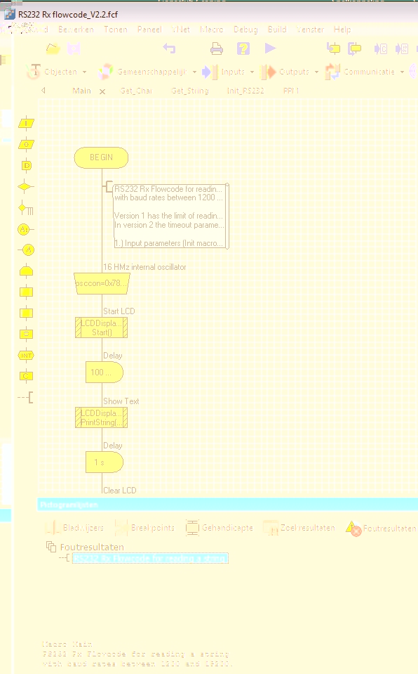

C error on text equal filename
Post by Jan Lichtenbelt »
Again in a complete other situation, I get an error in C on the place where the text in C is equal to the filename. Now the error is in the first comment, which indeed contains the filename. The filename in this case is "RS232 RX flowcode_V2.2". The error given is in the comment which contains: "RS232 RX flowcode".
Remark: Foutresultaten means error results.
(385.46 KiB) Downloaded 1168 times
It stays indeed very odd, but consistent.
