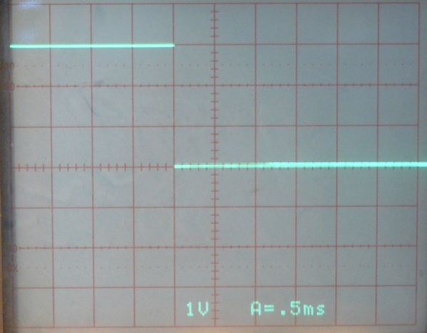

I have a pulse of about 1-2 msec with 50Hz (period time 20 msec), see picture 1.

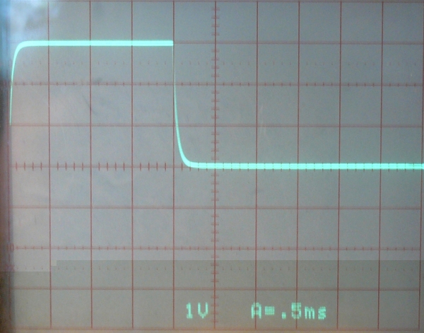

To measure the period time I use the interrupt-on-change (on port B3 of 16F1939). The interrupt is set only to rising edge. The timer used is Timer2 set on 19200 Hz (52 usec). If I use the pulse as given in picture 2 I measure a period time of about 288, which is 288 x 52 = 15 msec (correct see picture 1).
However if I change the pulse to the form as given in picture 3, I measure about 22-40, which is equal to 1-2 msec. And indeed the value change with the pulse length (repeating period stays unchanged). That means pulses like figure 3, not only the rising edge is detected, but also the falling edge. How is that possible????

I wonder if there is noise or something on the signal that is causing the IOC to trigger on a falling edge. i.e. a positive going spike during the falling edge. Your scope trace looks quite clean so I am surprised. Any chance you can add a cap or something to slow the signal voltage transition speed down a bit?
