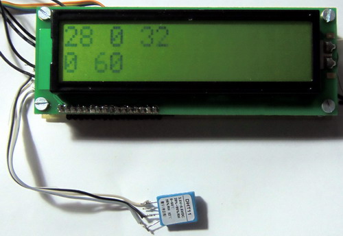

Hi, Ben!
I think it works!
Thank you very much!
