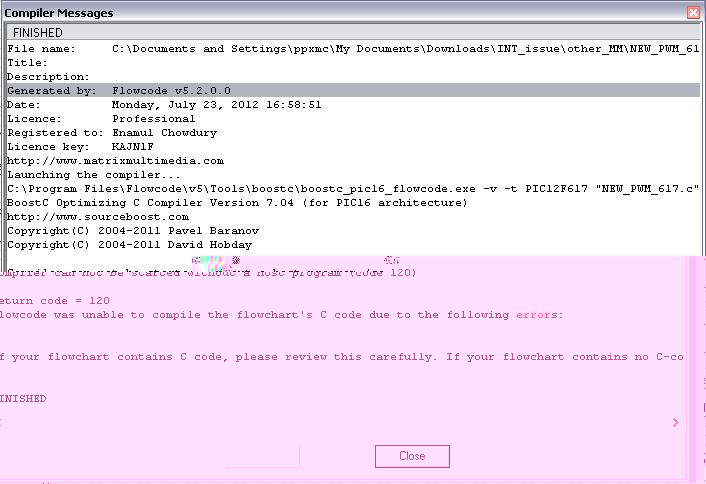

Has anybody ever seen this type of problem? Can anyone help me to sort out the problem? There is no C code in flow chart.

Powering down the PC and then re-launching Flowcode seems to have cleared this up. Any ideas as to why it happened?

Seems like you weren't running Flowcode as host.
Flowcode is trying to access the compiler at C:/program files/... probably and those folder are protected. Only host can request/open stuff from there like asking the compiler to compile your code.
That's my guess.

The Boost C licence we use only allows Boost C to be run from within Flowcode, to stop people using Boost C as a standalone compiler, this can sometimes happen if Boost C cannot be detected for some reason, ie Another version of Boost C is already loaded or it has been removed from the install, if a reboot has fixed it, nothing to worry about :)

Thanks David and Nicolas for the information. I am using Flowcode in the university machine where I have administrative privilege but I guess it happened to be changed in some case and this happens then.
