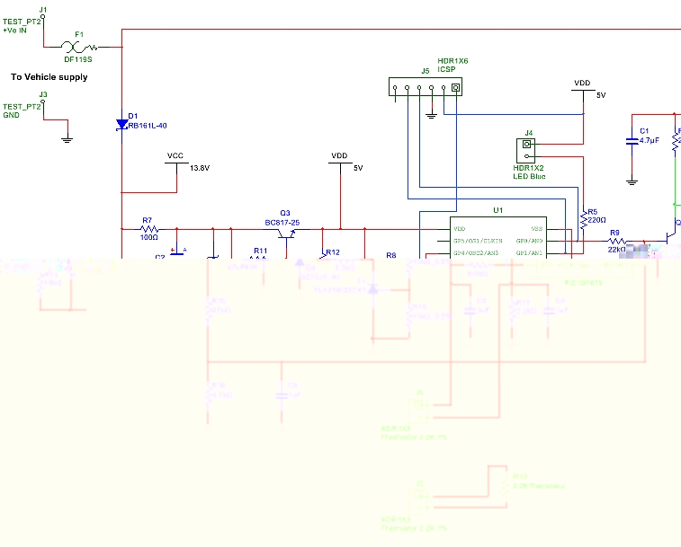

FYI, This is the front end of the circuit.....
Dave

Hi Martin,
Yes, division is approximately 6.....depending on ADC input loading, this is where I need to 'play' with conversions and calcs when I have the finished hardware on the bench......this I am ok with thanks.....or I hope I will be....lol.
Am waiting for PCB's to be delivered tomorrow, then I can build a couple and play with absolutes.
Many thanks again ....both of you guys.

One question.......do you think it would be ok to replace the 100K resistor, R8 with a 10k....saves me buying another value in......10K is used elsewhere in the circuit and would reduce cost/complexity...
Dave

daveb0360 wrote:One question.......do you think it would be ok to replace the 100K resistor, R8 with a 10k....saves me buying another value in......10K is used elsewhere in the circuit and would reduce cost/complexity...
Dave
It depends on the programmer you are using, but normally that should not be a problem at all. In the PICkit 3 documentation Microchip even suggests 4.7 - 10 K typical.

I agree with kersing,
10 K will be suitable as you can even go lower than this.

Enamul wrote:Hi,
I never used 100K in my circuit.. always 10K..so you can change that to 10K easily
Enamul
Thanks, I ended up using 22k.......I have these elsewhere in the circuit
Dave

Been thanked: 3815 times
Re: code for dual voltage 'window' on ADC input
Hi David,
Given safty requirements of your progect, I would suggest having watchdog enabled.
I also recommend using 12F617 instead of 12F675.
It has many advantages.
E.g twice as much memory (I have ran out of space with 12F675),
Cheaper,
can run at 4 or 8MHz,
Has 10bit PWM.
Also If I post a flowchart a bit later, it will be of your risk if you decide to use it.
Please only download and use if your going to accept full responsibily.
